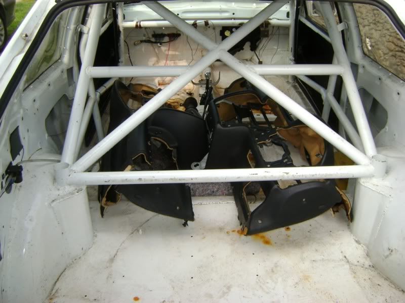

                      Re: Astra coil-overs fit North American Daewoo Lanos?
                      or like this same sort of thing
