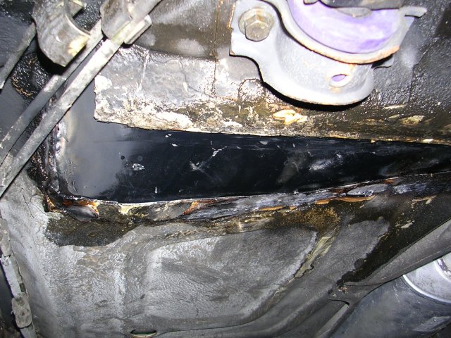

        awesome work L. good to see you charging on, hopefully use a bit of the enthusiasm vicariously
        this is gonna sound odd but those castellated bits of steel are on the road side on mine ? (what you call dragons teeth)
        wonder if yours had a patch or floor pan repair section applied from the roadside over the top of them in a previous life ?
            Thanks Darren, and DOH! indeed I had a patch there and therefore my teeth were on the outside originally (basically for me it just adds a bit of strength to that lip and ties it into the upper (& lower) patch I applied ahead of them, but as it meets the single skin floor around there it has little more than mental comfort factor thinking about it )
                  yeah definately no problem doing it like you have, i just ask question out of fear normally lol. think you might have answered it already, but the dragons teeth layer of steel where does the other end go? is it just another layer under the U clamp, or does it travel right up and meet something else?
                      The dragons teeth (I believe) is the subsection of the subframe to lower bulkhead/floor, basically there are three sections (that make up that area)
                      1) the subframe {space frame with the big holes and support for inner wishbone mount}
                      2) a skin that goes over (or is part of) the subframe has the big drain hole and just wraps up onto the chassis just a small bit just behind and "in a bit" of the wheel arch
                      3) the floor/body skin that is basically the floor
                      I'm sure the dragons teeth are item 2 and shaped like that to provide spot weld and locators (for anyone else reading, the dragons teeth are in reality 1/2 round holes along the edge of the plate and it was just easy for me to cut triangles ...lol).
                      Its a bummer but the parts diagram does not show that section in isolation (well not as far as I can find) ....
                      But I think you can just see it tailing off at the bottom of 28 on this diagram
                      Laurie.
