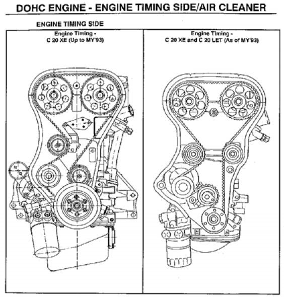

          • Re: 1989 gte rebuild
            Originally posted by BenH View Post
            Today started putting the engine back together, but a couple more problems. The bolt holes for the cambelt idler pulleys are m10 on the newer one compaired to m8 on the old one, probley as the engine mount is part of it on the mk4.
            So drilled out one side of the bracket, but the other side runs though the idler and into the block. 2 choices either use a m10 to m8 reducer or open out the bracket and idler pulley hole, the idlers are hardend but I might be able to die grind it open. I will try a old one first if it's a little off center it wont matter as it's on the back side of the belt anyhow, the newer type idlers have the correct size hole but the guide lip is backwards on them and rubs on the early backing plate.
            astra gte by ben a.k.a me, on Flickr
            Ben the idler setup looks way better than on a STD XE... would it be possible to set this up on an XE block? OOPS I didn't realise there was an early and late type of pulley setup!
            Is it possible to change mine to the late type with the round tooth belt cam pulleys? Watching the cam belt on the Dyno it scares me how much it flapps around with the long run from the cam to the low idler... this would eliminate that.
              I can see what you mean, the (early) xev setup is tha same as the xe late. The later xev setup (astra 4 ect) is simliar but has a engine mount with the pulleys in.
              Several things about though, only plastic pulleys are made prehaps not as good as the metal ones. The auto tensioner at the bottom is rubbish, if you turn the engine backwards when setting up a cam for example it can jump a tooth on the bottom pulley. This happend a couple of times before
              I have been trying to work out if i could fit a early xe type to mine lol! As it's meant to be safer at revs.
              Returned GTE to default settings : On axle stands
