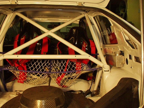

                  excuse the crudity of my picture, but it looks like they have done this, which is the idea i had in my head
                    Dont worry about the crudity - a picture speaks a thousand words as they say.
                    Thats what it looks like to me as well with trangulation back to the tube. I think that Id need to strengthen the pivot mountings as a first step, then tie that back to the cage like the photo shows as no point having one without the other.
                    Food for thought..
                    Paul..

                      yeah much food for thought! obviously we cant prove it, but i agree with steve, i can imagine it goes through the floor pan into the U section of the chassis rail that the beam mounts to.

                        I've had a dig thru various pictures i've got, and this is about the best i can find.
                        I believe it's a mk4 astra.

                          Re: New Rallycar Shell Build...
                          Thanks Steve
                          After a few thoughts, I think Im going to leave it without additional bracing to the rear mounts. Ive not had any issues with the old shell in that area and its already at the cage builders...
