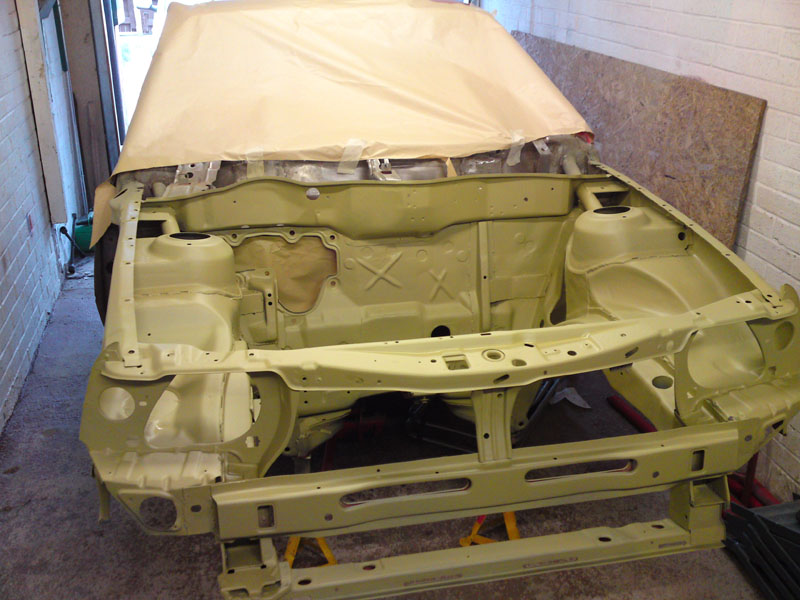

    I didn’t get much done on Sunday due to the crap weather we had and having to do the car on my drive.
    You can see the welding that needs doing.
    Here’s a better picture. I plan on doing similar to DarrenH and cut the mounting off, strengthen it from the rear and add some extra boxing and plating to the left to beef it all up.

                        Got a bit of welding done on the steering rack mount but after having a chat with a mate we now have a plan on how we are going to strengthen it properly, this will be done next weekend.

                            I spent along time looking at how to make it alittle stronger without it turning into an eyesore. You can see from the picture i've put a strip in that pretty much fits on the end of the rack, i've also double skinned the same area on the inside and taken a bar from the cage to it (got no pics of that yet).
                            There's a few other cheeky little mods to spot.. Hopefully i'll start on it again this year as it's amazing how much 2 year old can put a stop to things

                                After researching the various repairs people have done on their o/s steering rack mounts I had a cunning plan in my mind so it started last Saturday. As “The Steg” (more on him later) and I decided the cracks in the mount weren’t that bad so we cut into them and welded them up.
                                Mission “weld it” then began on Friday evening with a cardboard template.
                                Then some metal plates were made up using 3mm angle. I decided to use an Ian T design and plate the mount to the left stopping it moving up and down as well as side to side.
                                We then also decided we needed to use some angle so we could pickup the inner wing to rack mount. So prepped the whole area for welding.
                                Found a crack/split while cleaning up for welding.
                                I fully admit I’m no welding expert, more of a welding virgin. So arranged for The Steg to come round who is a welding guru.
                                Welding my crack up, oh err!!! Plus the obligatory welding FIRE!!!
                                My the plating commence.
                                Bit of a breather for The Steg.
                                The welding done and tidied up. Had to make sure there was enough room for the rubber rack mount to slide into place when bolting the rack into place.
