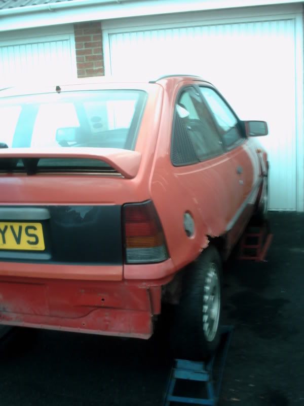

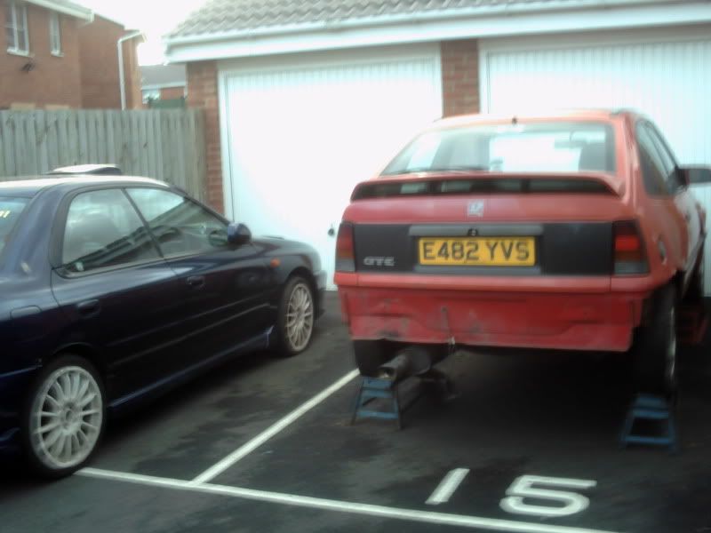

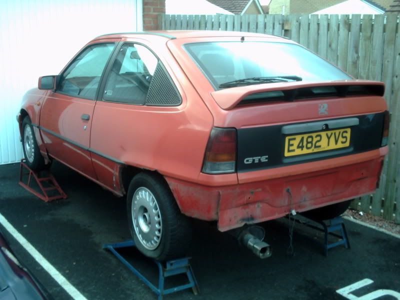

    Hi bought the car from Leicester last week, got her on ramps on next doors drive, Impreza now covered over, angle grinder can out.
    Removed both sills
    Chopped most of the rear corners out
    Bought to front wings
    Holes...........Holes and More Bloody holes.
    Few weekends and she'll be 100% better.

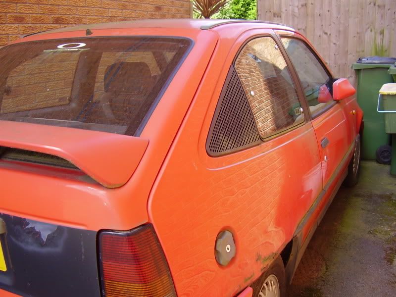

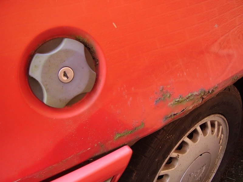

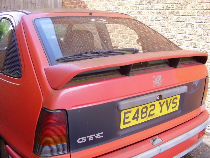

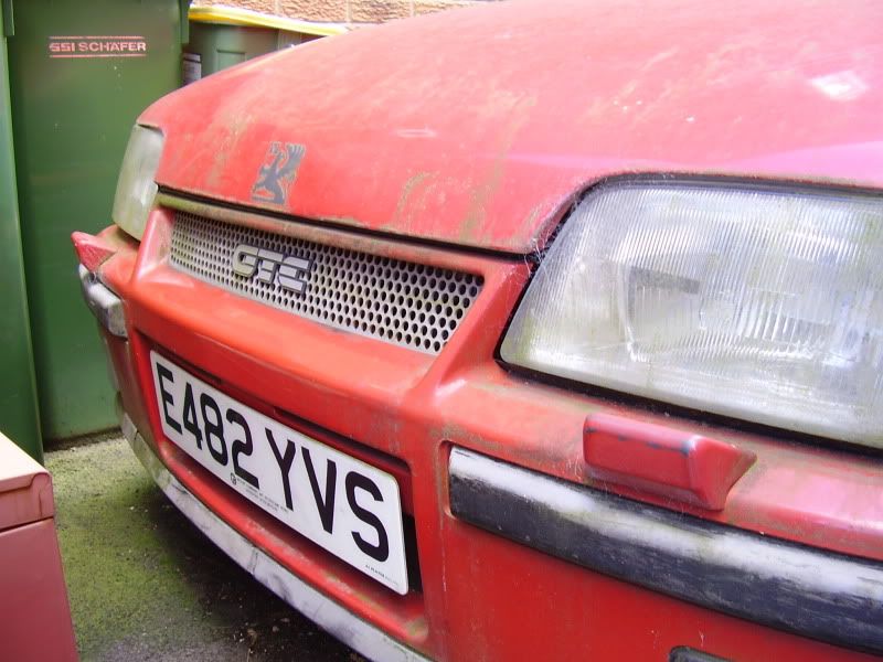

    A few pics of the car i was sent by the owner when i bought it from leicester.
    I have some more on my phone when i get them off, with it cleaned and at home on my drive, she is now on ramps, with sills and rear corners chopped off, will take pics soon.

              It has come up really well after a wash.....a lot better than i expected to be honest. Shame that the inner rear arches have gone also, but cant wait till i get her on the road.
              She runs (in a fashion) hope to get her puring ASAP.

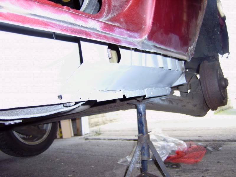

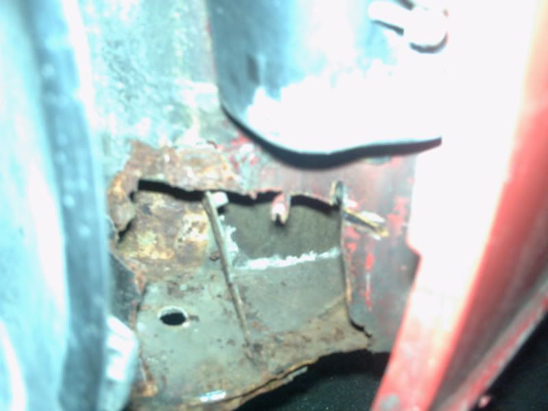

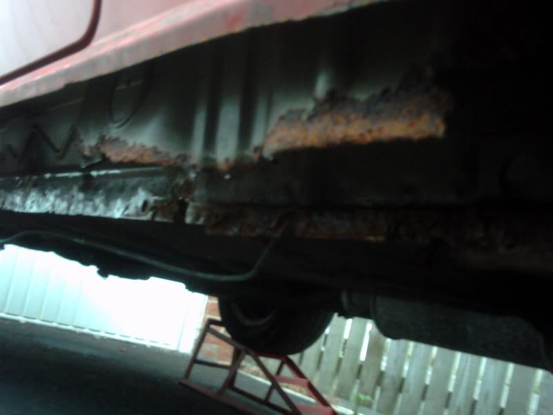

                  Whislt waiting to collect my sills, i have been having a look at others progess.
                  Mick8v has put sills on his ruby red motor, but i noticed he had put a plate from the inner sill to the little plate (strenghtening piece i think), I have removed my sills for the new already and there was no sign of these on either side of mine, they have either been removed or rotted long before the outer sills have.
                  Should i put them in?
                  What is thier purpose?
                  Taken from Mick8v
                  the reinforcing plate had rusted away so ive cut a plate and made it meet the inner sill, i read on here somewhere if the plates are left out it affects the handling?? dont really know what the original looks like but ive done what i think is right, its solid and doesnt foul the sill
                    Re: Red 8V Resto Started
                    Put em in!! it wont take long, any pics of your progress??

                      Im going to Mick

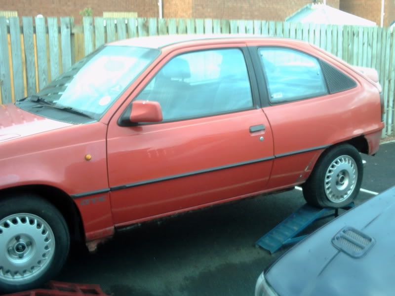

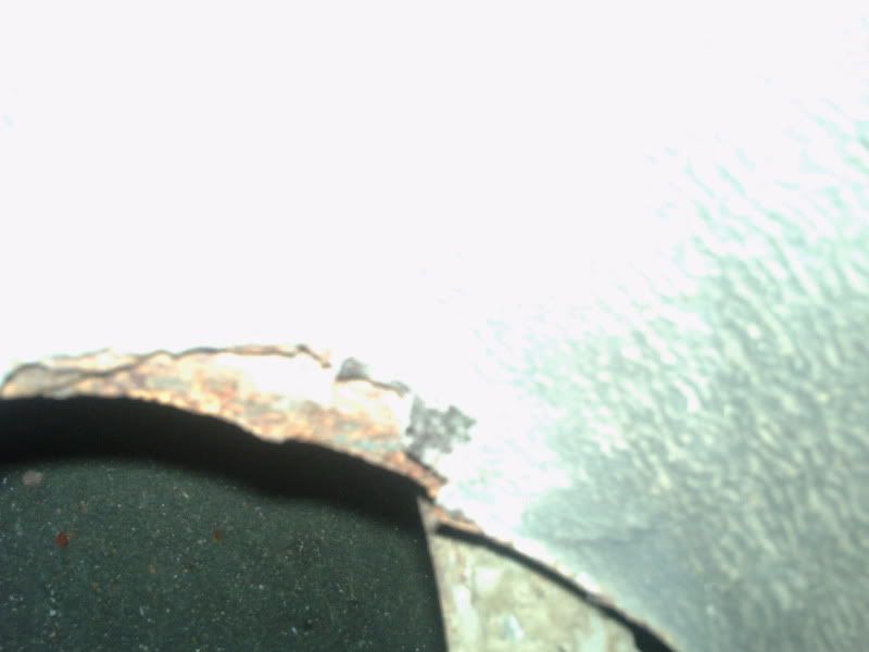

                        few more pics
                        Note below the non present reinforcing plate as mention above with Mick8vs pic
                        Search for holes found two small pass side and three small drivers side, right above the sill, but thats it.
                        Pass Side wheel arch where it meets sill
                        Driverside same position but more behind the wheel.
                        Waiting for sheet of steel to arrive for patches, car then to be moved to my dads units to begin welding and some panels, i have to make a decision if to get sills from MK2 John or from motorfactors as im not in newcastle area much, and impreza is off the road too now, cant ride my bike thats far.

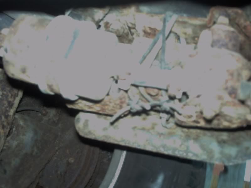

                        Oah pic of my fuel pump assy held on with zip ties, had a good look, i think it will all clean up but all the black rubbers died a long time ago can i get these from anyway or anyone know of a fix.
                          Doesnt look too bad, the little holes in the floor are where the brake pipe retaining clips mount to if you didnt know already, i got the fuel pump bushes from vaux but they come up on egay for around 6 quid a set, interior looks good, has it got manual windows??
