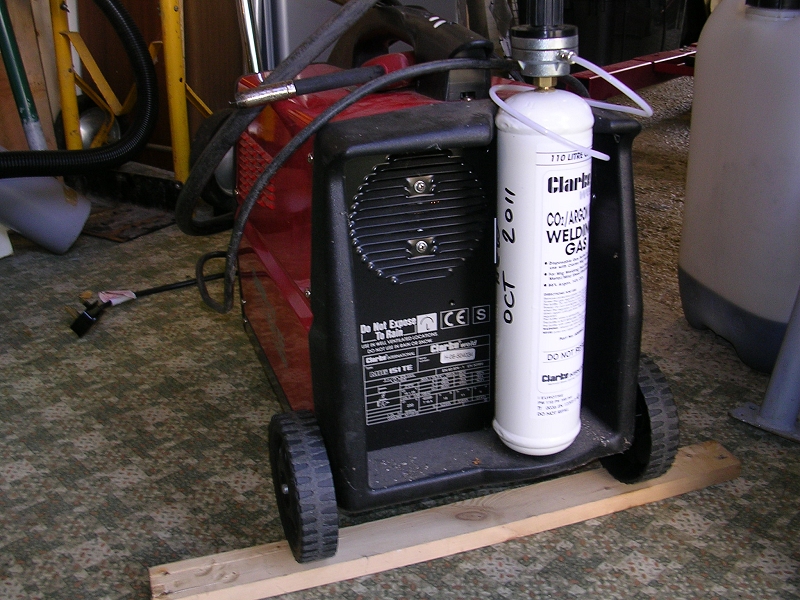

              the bottle in the original link, just like halfords and machine mart sell, if you set the regulator up for average in door welding (say 8-10 lpm) it will empty it in 6 minutes continuous welding. at face value you might think its a straight relationship of 60 litres divided by 10 litres per minute, but its just a coincidence because the bottle size is a litre.
              adams gas 9 litre 137 bar will last 2 hours continuous welding, and only costs 3 times as much as a disposable (to refill)

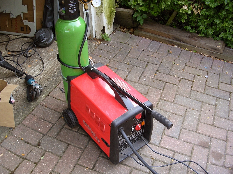

                  gives you an idea of the sizes, bottom pic is adamsgas 9 litre bottle
                    looks like that welder can do handbrake turns
