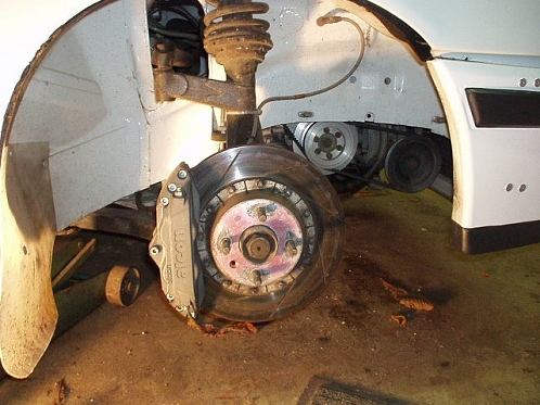

    Im thinking of building a set of coilovers for the front end, got a few question.
    What pound rating spring will in need? this will be a road car.
    Would i be better moving the stearing arm thing down the tube abit? if so by how much?
    What dampers would be best?
    Something like the one below (stolen picture of internet)
    Big block or small block?

      mines big block
        i was thinking of using normal type shocks, its the fab work i was showing.

            ill have a look at the parts. Any idea on the shocks? Adjustable ones id prefer,was looking at the gaz ones as ive got these on the back of by other car.
              the purpose of moving the steering arm down is so the threaded coilover sleeve can reach further, therefore bottom spring perch can be lower, longer spring, more travel (damper allowing of course)

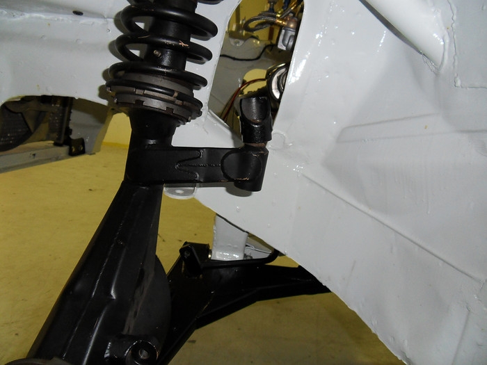

              proper pilbeam versions had the steering arm angled back up to the standard position so that the track rods are level (without this it would alter the bump steer) also the reinforcement between the steering knuckle and damper tube is a specialised welding work due to dissimilar metals. (cast steel and normal steel)
                Thanks for the info, the welding won't be a problem.see what you mean about the steering arm angled up.
                  heres an example of the group A works version, notice its angled up to correct

                    slightly better one
                      Thanks looks like it's a fully fabricated leg.

                        bang on, its a pilbeam group A works item. it was just to serve a purpose of showing the angled steering arm.
                        the opel sport group A legs were modified exactly like your original picture, but they still used standard pig tail springs....
