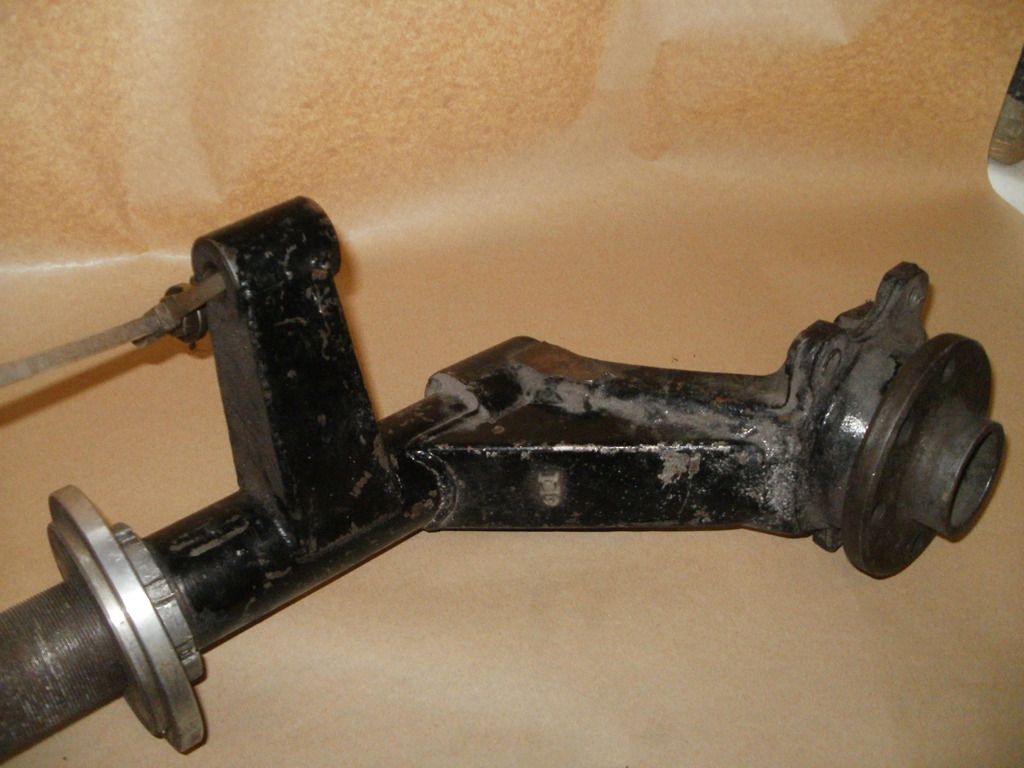

              proper pilbeam versions had the steering arm angled back up to the standard position so that the track rods are level (without this it would alter the bump steer) also the reinforcement between the steering knuckle and damper tube is a specialised welding work due to dissimilar metals. (cast steel and normal steel)
                Thanks for the info, the welding won't be a problem.see what you mean about the steering arm angled up.
                  heres an example of the group A works version, notice its angled up to correct
                    slightly better one
                      Thanks looks like it's a fully fabricated leg.

                        bang on, its a pilbeam group A works item. it was just to serve a purpose of showing the angled steering arm.
                        the opel sport group A legs were modified exactly like your original picture, but they still used standard pig tail springs....
