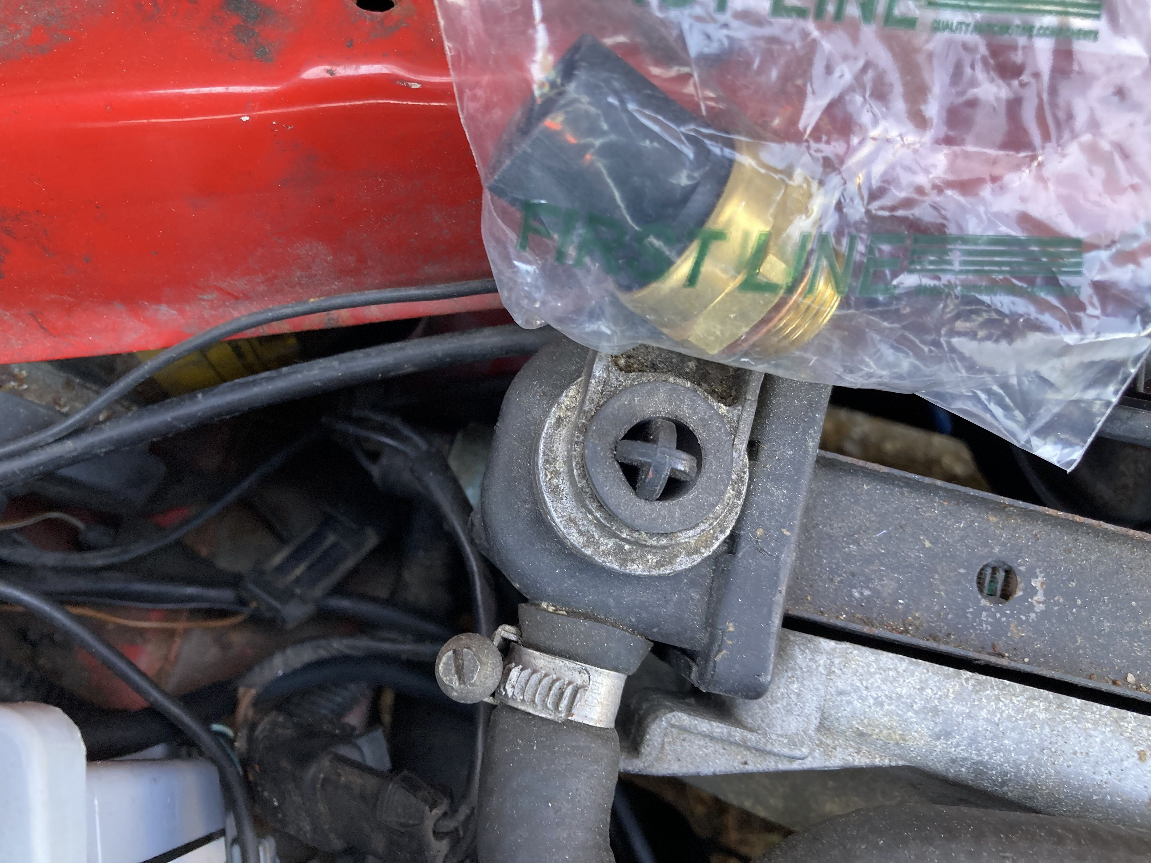

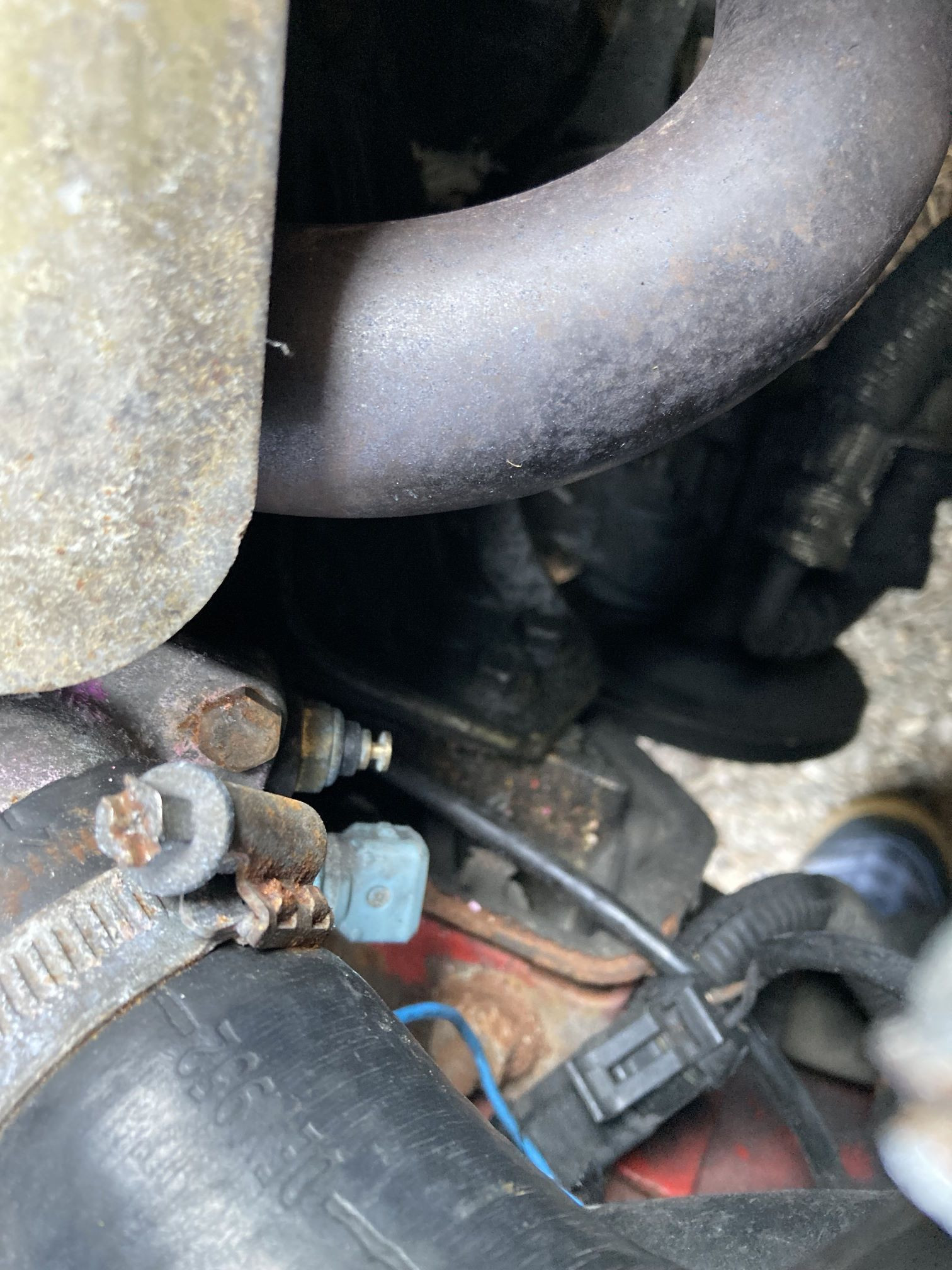

    yes so there are 3 temperature sensors: 1 for the telltale, 1 for the ECU, 1 for the fan control
    Fan Control sensor

    ECU (blue) tell-tale (slide on connector)
