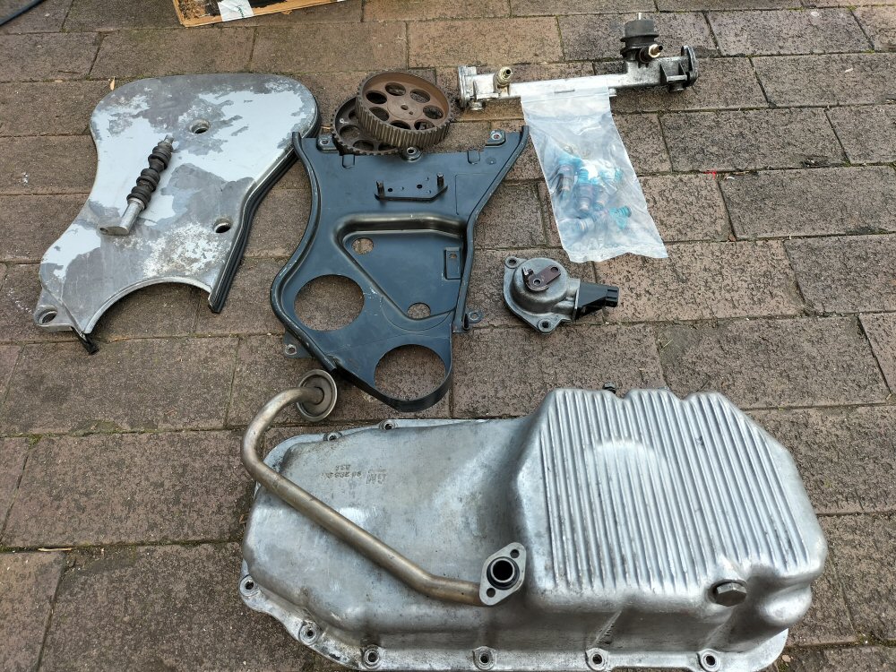

          Ok I have been just busy and collecting bits for the build. Given the XE only came out in one car in Australia it's been a big effort just to get parts.
          I already had a head as a spare from the Opel build and as mentioned I am going to put that onto my old C20NE rally motor. I found a chap in Poland on a Calibra forum so I managed to get this lot.
