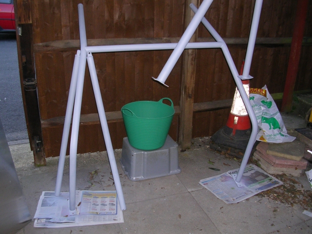

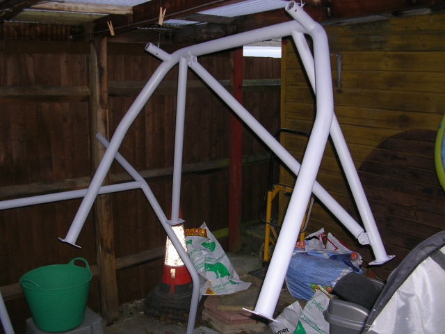

                              the OMP cage i bought was a knock down price old stock item, so its a few years old, its not painted, and its been in the damp shed for the last 2 weeks. so i had to polish off surface rust with some wire whool and elbow grease, then gave it a good coat of 1k acid etch primer.

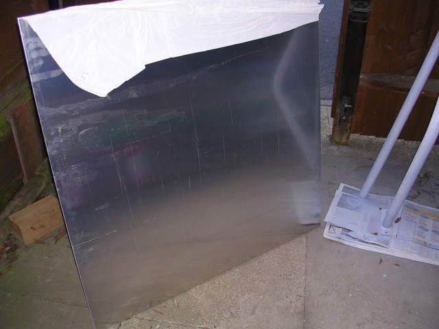

                              also went down to my local metal traders and picked up a meter square of 3mm aluminium sheet. i'll take the sunroof out with its supporting cage, then draw round the glas + enough overlap, then pop rivett it in place with seam sealer too.

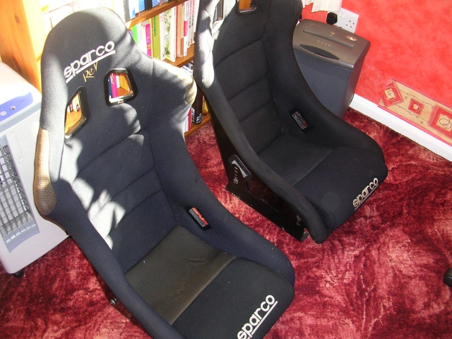

                              also big thanks to matt for pointing out these for sale on the GT4 owners club, a pair of sparco REV seats with side mounts. got them for an absolute bargain, probably saved a total of 500 quid if i wanted to replicate with brand new items.
