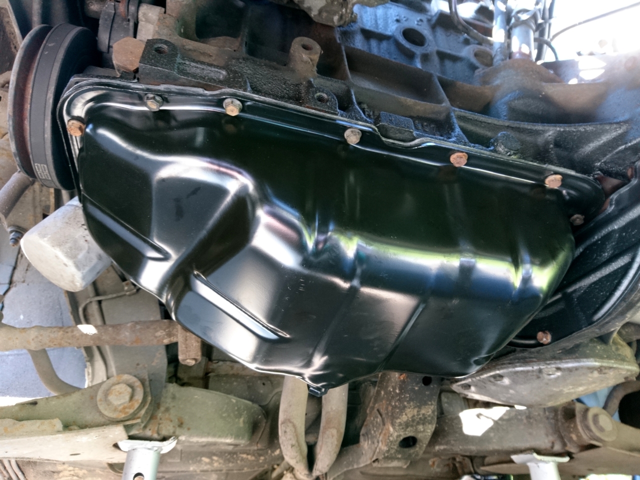

    close up of the sump plug "boss" no threads left whatsoever,

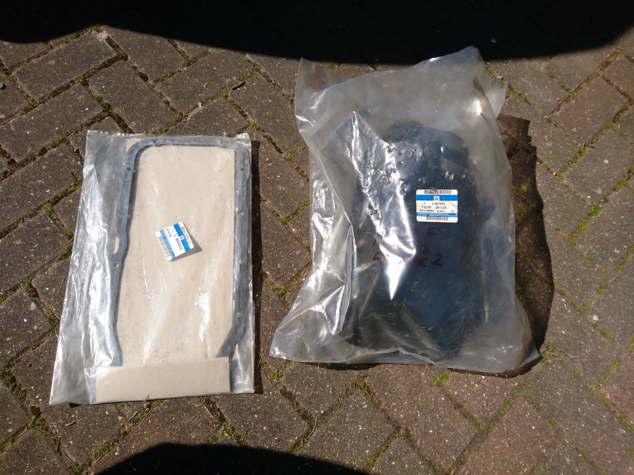

    new gear to go on, genuine sump gasket, its a weird gasket i could feel that it had metal strip inside it to add strength, plus it also has dowels round the bolt holes to stop you over tightening and distorting the sump
    all buttoned up. i dont go as far as painting bolts, sorry this is a working daily driver

        Yeah I found it on eBay last year for 32 quid! (it's was LMF selling it)
